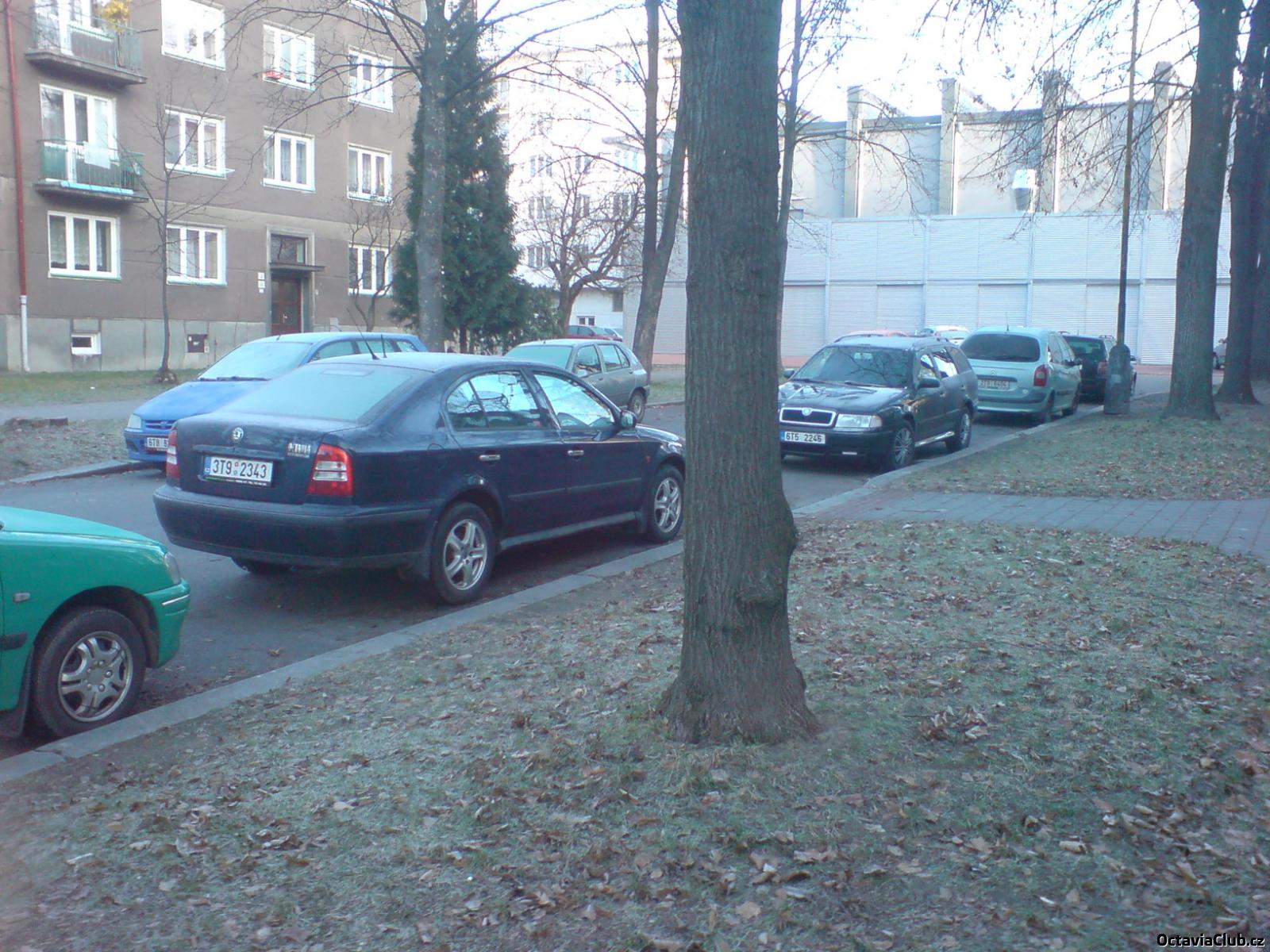

  4. http://www.youtube.com/watch?v=p7_LYYs3UKY
