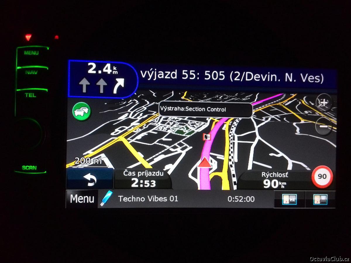

Na fore gpsunderground je vsetko, co potrebujes :)
Tu su mapy: http://gpsunderground.com/forum/gps-navigation-systems/garmin-gps-systems/garmin-maps/ ...najnovsie pre EU su zatial Europe NT 2015.20
A tu su cyclops kamery: http://gpsunderground.com/forum/garmin-pois/661-garmin-cyclops%E2%84%A2-safety-cameras-eu-au-na-za-ru-me.html
...a SCDB speed kamery: http://gpsunderground.com/forum/garmin-pois/7121-garmin-scdb-info-world-weekly-updates.html
Ked sa k tomu dostanes, tak ti dam info/postup co a ako ;)
